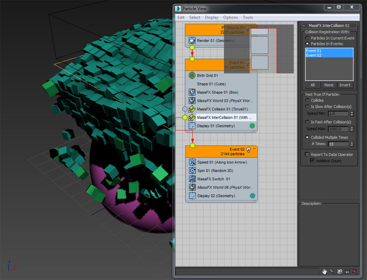

To illustrate the difference between the Collides and Collided Multiple Times options in the Test True If Particle group, look at another example: MassFXInterCollision02.max. This example contains two events, and particles are redirected to the second event if they collide with each other 15 times, according to # Times option. In the next event, particles are set to be static: Speed and Spin are equal to 0. The Speed and Spin values are set by regular Particle Flow operators (Speed 01 and Spin 01), but to make the particles static, a mParticles Switch operator is used.
If you play the animation, you can see that not all the particles were able to get the second event. This is because some of them did not collide at least 15 times during the course of the animation. As an exercise, decrease the # Times value to find how high this value can be while ensuring that all particles are transferred to the next event. This value is the smallest number of times a particle collides with other particles during the animation. Also, note that Collision Registration scope is set to Particles In Events, with all events highlighted. In this example, that means that we count all interparticle collisions.
