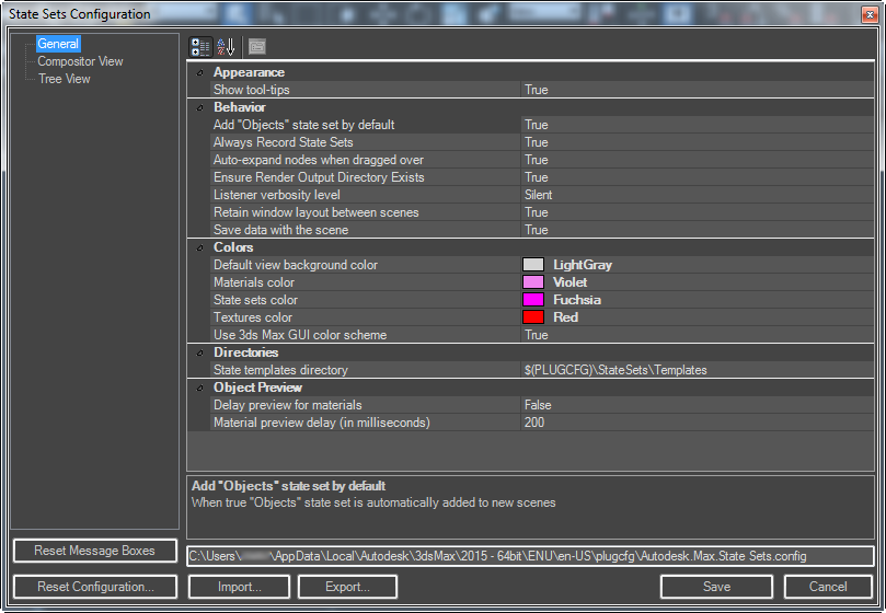

Use to customize the appearance and behavior of State Sets.
The dialog presents a variety of options. When you click an option, the dialog displays a description of it in a window below the options list.
- [panels]
- Use the list at left to navigate among the three right-hand panels.
Categorized: Click to sort the options by category.
Alphabetical: Click to sort the options alphabetically.
- Reset Message Boxes
- Click to turn off the "Do not show again" status of all State Sets messages that use that checkbox.
- [file name and path]
- Shows the name and location of the current State Sets CONFIG file.
- Reset Configuration
- Resets all configuration options to their default value.
- Import
- Loads a State Sets CONFIG file that has already been saved.
- Export
- Saves the current configuration to a State Sets CONFIG file.
- Save
- Saves the current configuration to the default CONFIG file Autodesk.Max.State Sets.config.
