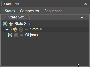

The State Sets dialog contains three main menus: States, Compositor, and Sequencer, plus their corresponding panels. Each panel also contains a number of right-click menus whose contents depend on the context.
The State Sets dialog features a hierarchical list of all defined states, displayed in a tree view. To highlight a state, click its name in the list. To highlight multiple states, drag over the list with the mouse, or press Ctrl or Shift and click.
In addition to the state name, each entry includes buttons for toggling various state properties. Also, if a state contains sub-states or has properties recorded, its list entry starts with a + or - icon to indicate that it can be expanded or collapsed, respectively.

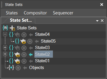

- Sub-State
- Adds a new sub-state as the child of the highlighted state. Sub-states are useful for layering different rendering passes or object settings. States can be nested any number of levels deep.
A sub-state reflects conditions set by the parent state or states in addition to its own conditions. For example, if only Light A is on in a parent state and only Light B is on in a sub-state, then rendered output from the parent state will show lighting only from Light A, while rendered output from the sub-state will show lighting from both lights.
Note: If you record different changes to the same properties for a state and its sub-state, the sub-state's property overrides its parent's when the sub-state is active or rendered.Note: You can also nest an existing state within another by dragging the state to be nested on top of its prospective parent. - Recorded property changes

Nested States
You can nest states, applying the child states to the parent's settings. For example, consider a scene where you have hidden an object in one state and changed render resolution in another state. If you nest the first state within the second, the first state will do both, hiding the object and changing the render resolution.
To nest states within another:
- Highlight the state or states to be nested.
Note: When highlighting a state to nest, be sure to click and release. Dragging over the state names in the list simply highlights the names.
- Drag and drop the highlighted states onto another state to nest them within that state.
To move states:
- First highlight the states to be moved, pause a moment, and then drag the highlighted states either on top of another state, for nesting, or between two other states for reordering.
While dragging, a green highlight at the cursor location shows the destination of the moved states.
