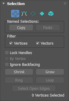

The Selection rollout provides buttons for selecting the sub-object level, working with named selections, display and filter settings, and displays information about selected entities.
Editable Patch has five levels of sub-object editing: Vertex, Handle, Edge, Patch, and Element. The selection you make at each level appears in the viewport as a component of the patch object. Each level maintains its own sub-object selection. When you return to a level, the selection reappears.
Clicking a sub-object level button here is the same as clicking a sub-object level in the modifier stack. Click the button again to turn it off and return to the object selection level.

Named Selections group
These functions work with named sub-object selection sets. To create a named sub-object selection, make the selection, and then enter a name in the Named Selection Sets field on the toolbar. For more information, see Named Selection Sets.

Filter group
These two checkboxes, available only at the Vertex sub-object level, let you select and transform vertices, vectors (handles on the vertices), or both. When a checkbox is turned off, you can't select the corresponding element type. Thus, for example, if you turn off Vertices, you can manipulate vectors without accidentally moving a vertex.
You can't turn off both checkboxes. When you turn off either checkbox, the other one becomes unavailable. At that point, you can manipulate the element corresponding to the checkbox that's on, but you can't turn it off.

- [selection Information]
- At the bottom of the Selection rollout is a text display giving information about the current selection. If multiple sub-objects are selected, or none is selected, the text gives the number and type selected. If one sub-object is selected, the text gives the identification number and type of the selected item.
