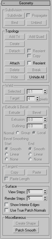

The functions available at the editable patch object level (that is, when no sub-object level is chosen) are also available at all sub-object levels, and work exactly the same at each level.
Interface
Selection rollout
For information on these settings, see Editable Patch Surface.
