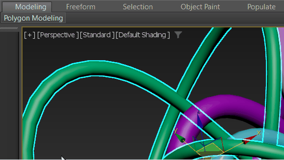

You can quickly access various statistics related to your current selection and entire scene.
Procedures
To use the viewport statistics display:
- Choose Customize menu
Viewport Configuration dialog
Statistics panel.
- Activate the viewport in which to display statistics.
- Toggle the statistics display by pressing
7 or right-clicking the viewport label and choosing xView
Show Statistics.
Interface
You can customize the viewport statistics by turning on and off options on the Statistics panel of the Viewport Configuration dialog. The following statistics reflect all options turned on.
The first column lists the statistics for the entire scene, while the second only refers to the selected objects.
- Polys
Displays the number of polygons in the scene and selection.
Note: This is valid only for poly objects. - Tris
Displays the number of triangle faces in the scene and selection.
Note: If you select a polygon in a poly object, this option shows two or more triangles. - Edges
Displays the number of edges in the scene and selection.
- Verts
Displays the number of vertices in the scene and selection.
- FPS
The frames per second displayed in the viewport.
