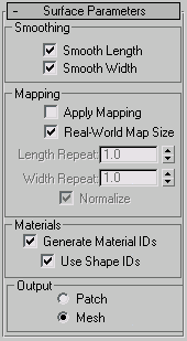

On the Surface Parameters rollout, you control smoothing of the surface of the loft as well as designate if texture mapping is applied along the loft object.

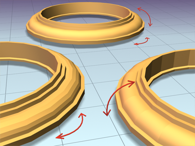

Smoothing group
Left: Smoothing the length
Right: Smoothing the width
Rear: Smoothing both length and width
- Smooth Length
- Provides a smooth surface along the length of the path. This type of smoothing is useful when your path curves or when shapes on the path change size. Default=on.
- Smooth Width
- Provides a smooth surface around the perimeter of the cross-section shapes. This type of smoothing is useful when your shapes change the number of vertices or change form. Default=on.

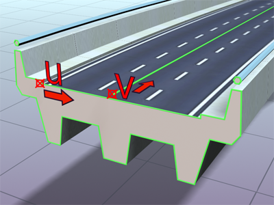

Mapping group
Bitmap used to create the lines on the road
Mapped roadway showing U and V dimensions for the loft

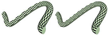

- Normalize
- Determines how path vertex spacing affects a map along both the path length and shape width. When on, vertices are ignored. Map coordinates and Repeat values are applied evenly along the length of the path and around the shapes. When off, major path divisions and shape vertex spacing affects map coordinate spacing. Map coordinates and Repeat values are applied proportionally according to the path division spacing or shape vertex spacing.
Before and after applying Normalize to loft

- Use Shape IDs
- Offers the choice of using the spline material IDs to define the material IDs. Note: Prior to version 3 of 3ds Max, splines could not hold material IDs.Note: Shape IDs are inherited from shape cross sections, not from the path spline.
Shape material IDs used to give the roadway two materials: concrete for supports and railings, asphalt with white lines for the traffic lanes
