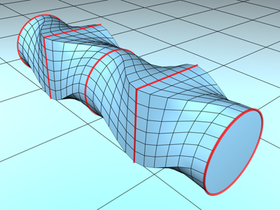

Inserting different shapes at different positions on the path
