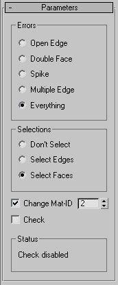

The message in the Status group shows if errors are found. STL Check indicates errors by selecting the problem geometry, assigning it a special material ID, or both.
Interface
Errors group
Choosing one of these options selects incorrect geometry specific to the choice, and selects it depending on the option chosen in the Selections group.
- Open Edge Checks for open edges (holes).
- Double Faces Checks for faces that share the same 3D space.
- Spike Checks for spikes, which are isolated faces that share only one edge with the object.
- Multiple Edges Checks for faces that share more than one edge.
- Everything Checks for all of the above.
Selections group
These options specify the level of incorrect geometry that's selected, based on the settings in the Errors group.
- Don't Select When chosen, STL Check doesn't select any part of objects in error.
- Select Edges When chosen, STL Check marks the edges of faces in error by selecting them. The selection of erroneous edges is visible in viewports.
- Select Faces When chosen, STL Check marks the faces of any object in error by selecting them. The selection of erroneous faces is visible in viewports.
- Change Mat-ID
When on (the default), STL Check also marks faces in error by assigning them a unique material ID. Use the spinner to choose the value of the material ID that STL Check uses.
- Check
Turn on to perform the STL check. For complex models, expect a pause between the time you turn this on, and the time you see the reported errors in the Status group. Default=off.
Status group
Displays the number of errors when Check is on.
