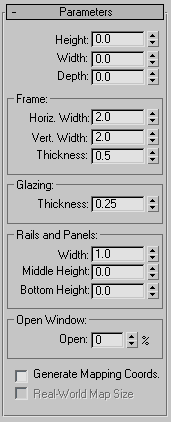

Parameters rollout
The topic for each kind of window describes its unique controls and behavior. Some window parameters are common to all kinds of windows; see Windows.
Rails and Panels group
Width
Sets the width (depth) of the rails in the sashes.
Middle Height
Sets the height of the middle sash, relative to the window's frame.
Bottom Height
Sets the height of the bottom sash, relative to the window's frame.
Open Window group
Open
Specifies the percent that the two movable sashes are open. This control is animatable.
