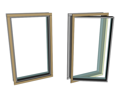

The Casement window has one or two sashes that are hinged on the side, like a door.

Casement window

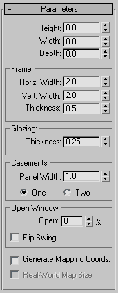

Parameters rollout
The topic for each kind of window describes its unique controls and behavior. Some window parameters are common to all kinds of windows; see Windows.
Casements group
Panel Width
Changes the size of the glazed panel within each sash.
One/Two
Specifies the number of window panels: one or two. Using two panels creates a window like a double door; each panel is hinged on its outside side edge.
Open Window group
Open
Specifies the percent that the window is open. This control is animatable.
Flip Swing
Turn this on to have the sashes open in the opposite direction.
