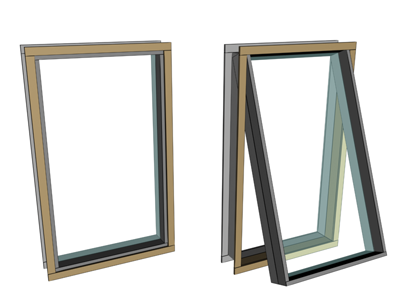

The Awning window has one or more sashes that are hinged at the top.

Awning window

Rails and Panels group
Width
Sets the width (depth) of the rails in the sashes.
Panel Count
Sets the number of sashes in the window. If you use more than one sash, each is hinged at its top edge. Range=1 to 10.
Open Window group
Open
Specifies the percent the window is open. This control is animatable.
