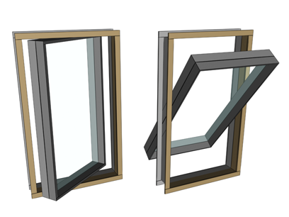

The Pivoted window has one sash only, hinged midway through the side of the sash. It can swing open either vertically or horizontally.
  • Create panel > (Geometry) > Windows > Object Type rollout > Pivoted button
  • Default menu: Create menu > AEC Objects > Pivoted Window
  • Alt menu: Objects menu > Architectural Parts > Pivoted Window
Pivoted windows

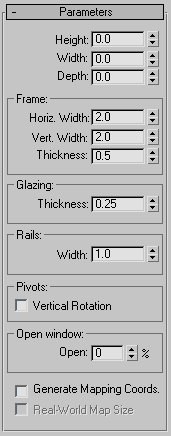

Parameters rollout
The topic for each kind of Window describes its unique controls and behavior. Most Window parameters are common to all kinds of Windows; see Windows.
Rails group
Width
Sets the width of the rails in the sash.
Pivots group
Vertical Rotation
Switches the pivot axis from horizontal to vertical.
Open Window group
Open
Specifies the percent that the window is open. This control is animatable.
