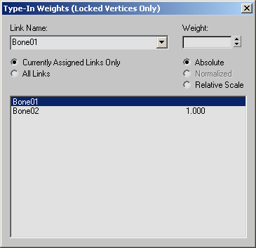

The Type-In Weights dialog lets you enter a weight for selected locked vertices. To use this dialog, select one or more vertices, lock them, click Type-In Weights to display the Type-In Weights dialog, use the lists in the dialog to select a link, and then change the weight to that link in order to position the vertices. Vertex positions update in viewports as the weight changes.
Interface
- Link Name
- Use the drop-down list to select a link and display the vertex weight to that link.
- Currently Assigned Links Only When chosen, displays only those links that presently influence the selected vertices.
- All Links When chosen, displays all available links.
- Weight
Displays the vertex weight for the active link (the link currently displayed by the Link Name list). Use the spinner to change the weight value, if necessary.
- Absolute Uses an absolute value for vertex weight.
- Normalized This option is unavailable in character studio.
- Relative Scale Uses relative values for vertex weights.
This is the mode of choice when you work on multiple vertices. If a particular link is not having a strong enough effect on the selected vertices, you should lock them, open the Type-In Weights dialog, select the link, and choose Relative Scale. Then you can enter relative values in the Weight field. For example, entering 1.0 leaves weights the same, while entering 2.0 would double the effect of the selected link on the selected vertices.
- [list of links]
- Displays a list of links, with weight values at the right. The weight field is blank when it displays absolute weights. (When more than one vertex is selected, each is likely to have a slightly different weight.) Click a link in this list to select it.
