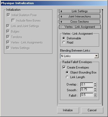

Use the Physique Initialization dialog to specify link parameters and the type and size of envelopes to create for Physique links.
  • Select an object that has the Physique modifier applied to it. > Modify panel > Physique rollout > Click (Attach To Node). > Pick a root object in a viewport. > Physique Initialization dialog
  • Select an object that has the Physique modifier applied to it. > Modify panel > Physique rollout > Click Reinitialize. > Physique Initialization dialog.

Creating Physique Links and Envelopes for the First Time
When you use Attach To Node to attach the mesh to a skeleton for the first time, you can use parameters on the Vertex-Link Assignment rollout to specify envelope parameters. In most cases, the default parameters on the Vertex-Link Assignment rollout work well as a starting point for envelope type, envelope sizing, and blending between links.
Normally, you want deformable envelopes. Blending Between Links is set to N Links (a vertex can be influenced by all envelopes that overlap it). The Object Bounding Box option is chosen by default, and bases the size of the envelopes on the size of biped limbs or bone diameters.

Initialization group
The Initialization checkboxes are normally unavailable and not changeable during initialization. Although these options are unavailable, they are all turned on by default (except Include New Bones) for initialization, since all these settings are new when you use Attach To Node for the first time.
These checkboxes become available when you click Reinitialize on the Physique rollout.
See Reinitialize Physique for a description of the controls in this group.

Vertex-Link Assignment Rollout
On the Vertex-Link Assignment rollout you can create new envelopes and pick the type of blending between links.
