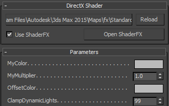

  4. Select the newly created Color node. On the Properties panel, enter the name OffsetColor and change the UI Order value to 3.
    OffsetColor now appears on the Material Editor Parameters rollout.
