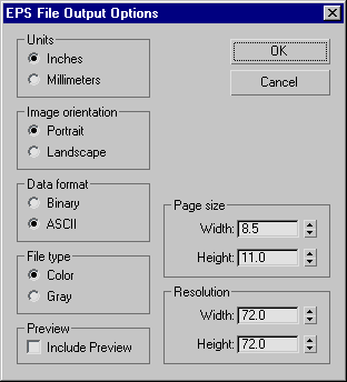

Interface
When PostScript is the chosen output format, clicking Render or Setup on the Render Output File dialog displays the EPS File Output Options dialog.
- Units
Select inches or millimeters.
- Image Orientation
Select portrait (tall) or landscape (wide).
- Data Format
Select binary or ASCII.
- File Type
Select color or grayscale.
- Preview
Check to generate a thumbnail image so that file browsers can preview the contents of the PostScript file.
- Page Size
Set width and height measurements.
- Resolution
Set width and height resolution in dots per inch (dpi).
