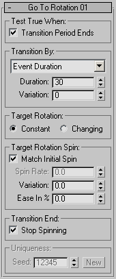

Interface
The user interface appears in the parameters panel, on the right side of the Particle View dialog.
Test True When group
- Transition Period Ends
- When on, the particles test True at the end of the specified transition period, and become eligible for redirection to the next event. When off, particles will not go to the next event, even if wired. Turn off to disable the test aspect of Go To Rotation. Default=on.
Transition By group
Determines how Particle Flow applies the specified timing, defined by the Time and Variation values. Default=Event Duration.
The possible options are:
- Absolute Time Time refers to the overall time of the system. Each particle will reach its target orientation at the frame number specified by Time.
- Particle Age Time refers to the time elapsed since the birth of the particle. Each particle will reach its target orientation when its age reaches the value specified by Time.
- Event Duration Time refers to the time elapsed since the particle entered the current event. Each particle will reach its target orientation when it has been in the current for the number of frames specified by Time.
- Duration
- The number of frames particles should take to reach the target orientation. Default=30.
- Variation
- The number of frames by which Duration can vary randomly. Default=0.
To obtain the actual time to the target orientation for each particle, the system multiplies the Variation value by a random number between -1.0 and 1.0, and then adds the result to the Duration value. For example, if Duration=60 and Variation=20, then the time to target orientation for each particle would be between 40 and 80 frames.
Target Rotation group
When you use an orientation-type operator with Go To Rotation, this setting lets you determine whether the test sets the target orientation on a one-time or ongoing basis.
- Constant (The default.) Defines that the orientation-type operator sets a constant orientation for a particle.
For example, when using a Rotation operator set to an orientation matrix other than Speed Space Follow, the Go To Rotation operator would acquire the target orientation only once, and then use it as its goal.
- Changing Defines that the orientation-type operator sets a changing rotation for a particle. At each frame the desirable final rotation may be different.
For example, if you use the test with a Rotation operator set to Speed Space Follow, the test will adjust the particle rotation constantly to aim at the changing final rotation.
Target Rotation Spin group
Defines the angular velocity for each particle when it reaches the target orientation.
- Match Initial Spin
- Sets the angular velocity at the end of the transition period to the same as the angular velocity when particle enters the event. Note: The axis of rotation might still be different, because it is calculated on the fly to let the particle come to the target orientation.
- Spin Rate
- Defines each particle's angular velocity, in degrees per second, when it reaches the target orientation. Available only when Match Initial Spin is off. Default=0.0.
For a smooth transition to the target orientation, set to 0.0.
- Variation
- Defines a random variation in the Spin Rate value when a particle reaches the target orientation. Default=0.0.
To obtain the final angular velocity for each particle, the system multiplies the Variation value by a random number between -1.0 and 1.0, and then adds the result to the Spin Rate value. For example, if Spin Rate=6.0 and Variation=1.0, then the final angular velocity for each particle would be between 5.0 and 7.0 degrees per second.
- Ease In %
- Defines a curve in achieving the final spin rate. Default=0.0
When set to 0.0, the test produces a linear interpolation between the initial and final spin rate, and when set to 100.0, the final spin rate is achieved earlier. For the smoothest approach to the target orientation, set Spin Rate and Variation to 0.0, and Ease In to 100.0.
Transition End group
- Stop Spinning
- When on, halts particle rotation when it reaches the target orientation. Default=on.
Even with Spin Rate spinner set to 0.0, we recommend that you keep this checkbox on to avoid slow spinning at the end, due to computational averaging and marginal errors.
Uniqueness group
The Uniqueness setting enables randomization of the Variation options.
- Seed
- Specifies a randomization value.
- New
- Calculates a new seed using a randomization formula.
