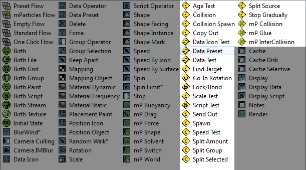

All the tests are grouped together in the Particle View depot, and are listed in alphabetical order. The icon for all tests is a yellow diamond, usually containing a simplified diagram of an electrical switch.
The Particle Flow tests in the Particle View depot
