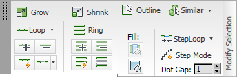

Modify Selection Panel
The Modify Selection panel provides tools for adding to and subtracting from sub-object selections, both in general and with respect to loops and rings.
  • Ribbon > Modeling tab > Modify Selection panel
Interface
Modify Selection panel on minimized ribbon
Modify Selection panel on maximized ribbon, with expansion
Modify Selection panel floating, with expansion
