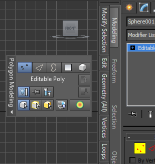

Because this is perhaps the most commonly used panel, you might want to float it separate from the ribbon (“tear” it off by dragging the panel label), and use the rest of the ribbon minimized, to maximize screen real estate.
Recommended setup: The ribbon is docked and minimized, while the Polygon Modeling panel floats.
Interface
Polygon Modeling panel on minimized ribbon
Polygon Modeling panel on maximized ribbon, with expansion
Polygon Modeling panel floating, with expansion

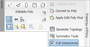

Note: When the ribbon is maximized or the Polygon Modeling panel floats, the following controls appear on the Polygon Modeling panel expansion.
Collapse Stack
Same as Collapse All: Collapses the selected object’s entire stack to an editable object that preserves the cumulative effect of the collapsed modifiers on the base object. See Collapsing the Stack.
You can use the Graphite Modeling Tools with an object that results from collapsing the stack only if it’s an editable poly.
Convert to Poly
Converts the object to editable poly format and switches to Modify mode.
This is the quickest way to start using the Graphite Modeling Tools on an object.
Apply Edit Poly Mod
Applies the Edit Poly modifier to the object and switches to Modify mode.
Generate Topology
Opens the Topology Dialog with tools for adjusting the object’s geometric makeup.
Symmetry Tools
Opens the Symmetry Tools Dialog with controls for making models symmetrical.
Full Interactivity
Toggles the level of feedback for the QuickSlice and Cut tools, as well as all settings dialogs and caddies. Available with editable poly objects, but not the Edit Poly modifier.
When on (the default), 3ds Max updates the viewport in real time as you use the mouse to manipulate the tool or change a numeric setting. With Cut and QuickSlice, when Full Interactivity is off, only the rubber-band line is visible until you click. Similarly, with numeric settings in caddies, the final result is visible only when you release the mouse button after changing the setting.
The state of Full Interactivity doesn't affect changing a numeric setting from the keyboard. Whether it's on or off, the setting takes effect only when you exit the field by pressing Tab or Enter, or by clicking a different control in the dialog.
