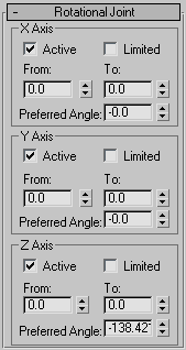

Here are the controls for setting the joint limits when using the HI Solver. You can turn X, Y, or Z axes on or off, limit them, and set those limits here. This is also where the preferred angle is defined, and adjusted. The preferred angle defines the direction a chain will bend, which angle a chain will tend to rotate toward.

Select any bone in the chain. - On the
Hierarchy panel
IK panel, open the Rotational Joint rollout. - There are three axes. Find the one with the preferred angle that is not zero.
- Change the preferred angle. If it is negative make it a positive one.
Play the animation. Changing the preferred angle can redefine the direction of the rotation.

To set rotational joint limits on a hierarchy of objects or a bone chain:
- Create a bone chain or a hierarchy of objects.
Select any object in the chain. - On the
Hierarchy panel
IK panel, open the Rotational Joint rollout. - If you want to limit an axis, turn on Active and Limited, and set the values of From and To. The hierarchy will rotate in the viewport. Tip: Pressing the From and To labels instantly rotates the bone to those angles.

Rotational Joints rollout
X, Y, and Z Axis groups
- Active
- Activates an axis (X, Y, or Z). Allows the selected object to rotate about the activated axis.
- Limited
- Limits the range of rotation allowed on an active axis. Use in conjunction with the From and To spinners. Most joints are limited in their range of rotation along an active axis. For example, a wheel rotating around an axle could be limited to rotate around only one axis.
- From and To Spinners
- Determine for rotation limits. Use in conjunction with the Limited function. Clicking the labels From and To rotates the object to its limit rotation. Use this to check the rotation limits on an object.
- Preferred Angle
- Used by the HI Solver to set the initial pose for internal calculations. Determines the direction of rotation preferred by a bone.
