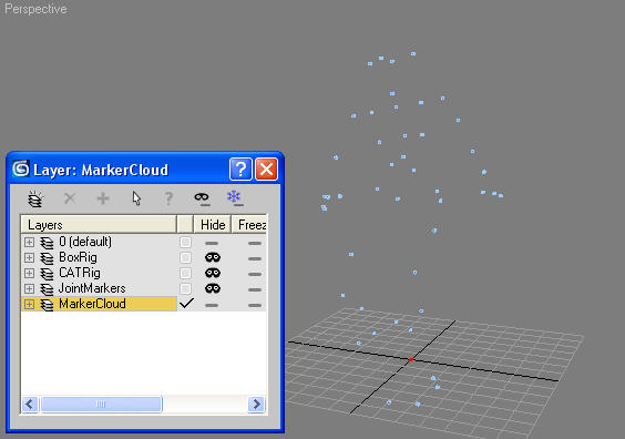

Point Cloud
The original motion-capture data cloud

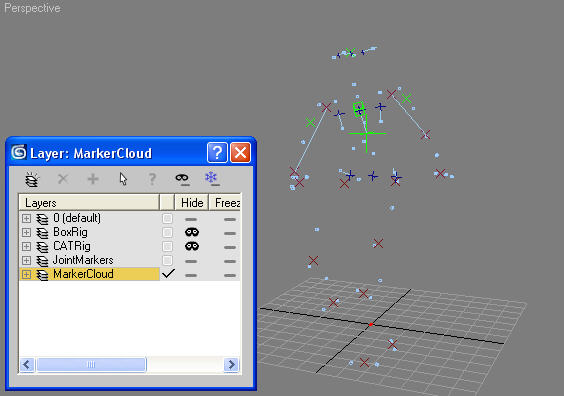

Joint Positions
The first layer is for generating joint positions in the cloud using Point constraints. The joint positions are simply weighted Position constraints, and therefore relatively easy to set up. The red crosses in the scene file represent basic joint position helpers.
A group of three Point helpers is used to define the pelvis orientation based on surrounding markers. An identical setup is used to drive the orientation of the ribcage and head. These are the blue points in the illustration.

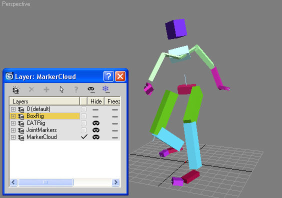

Box Rig
The second layer is the BoxRig, which defines the joint angles. Boxes are constrained to the joint positions and LookAt controllers define rotations. Note that the exact position of many of the bones is not important. For example, the knee joints move relative to the hip bone, but when this data is mapped onto the CATRig, the latter’s IK system effectively cleans up the motion and locks the joint locations.

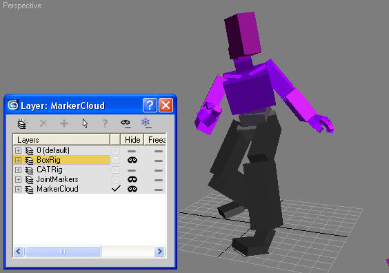

CATRig
The CATRig has been mapped onto the BoxRig using the Capture Animation tool.
