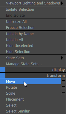

  3. Right-click the Perspective viewport and choose Move from the menu.
    This right-click menu is called the quad menu. You can use it to access tools from the toolbar and command panel for quicker workflow. You can even customize it to keep your favorite tools right under your fingertips.

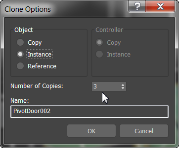

  3. Hold down the Shift key and position your cursor over the Z axis in the transform gizmo in the viewport until the axis turns yellow. Then click and drag slowly to rotate the door until Z= 90 degrees in the Coordinate display. Release the mouse button.
    Holding down Shift as you transform an object serves as a quick way to clone the object.
  4. On the Clone Options dialog, set Number Of Copies to 3, choose Instance (if necessary), and click OK.
    Now there are four doors within the enclosure.
