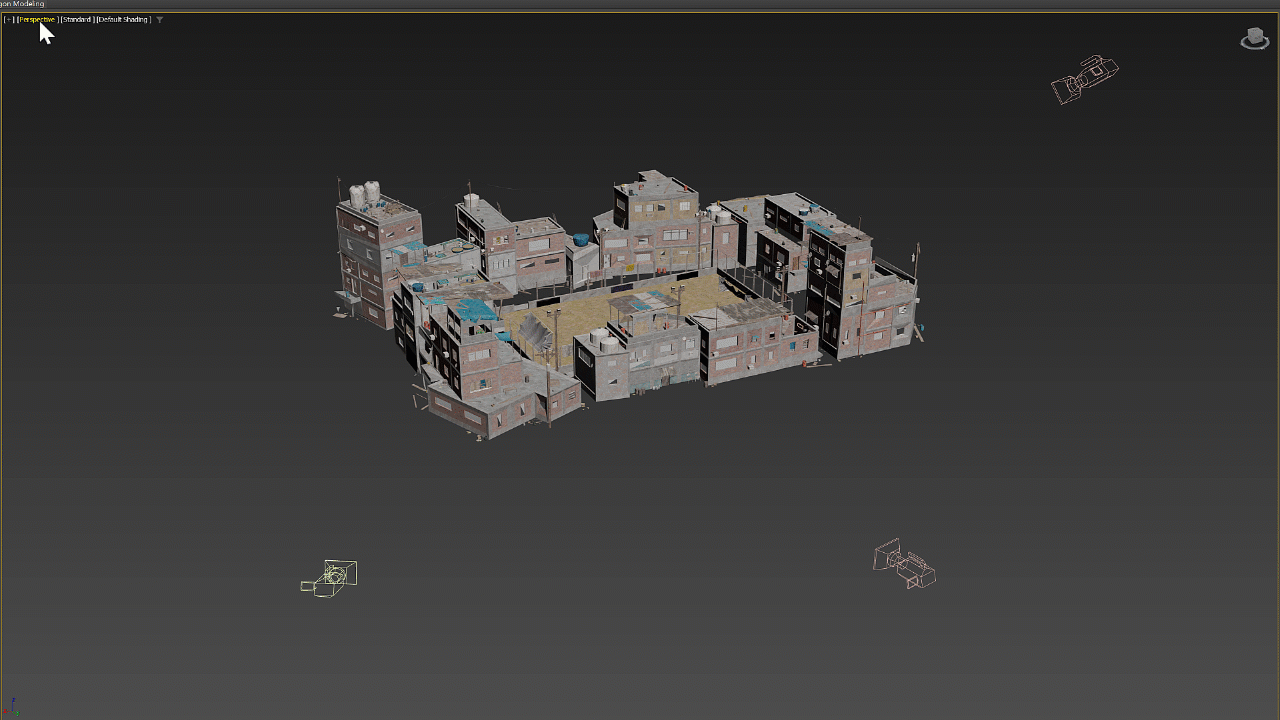

Updated Universal Scene Description (USD) plug-in adds the ability to use USD cameras inside the 3ds Max viewport.
What's New in USD for 3ds Max 0.8
  • Ability to use USD cameras inside viewport
    With this update, you can now use the cameras in a USD stage in the viewport. With this feature, you can see the camera compositions of the referenced file, including angles, field of view and animations.
