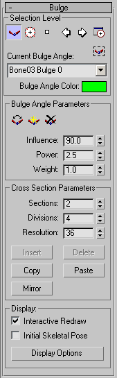

Interface
Controls for the Bulge sub-object level are on the Bulge rollout.
Selection Level group
Link - Turn on to select links in the viewports. The Copy, Paste, and Mirror commands are enabled for links.
Cross Section - Turn on to select and edit cross sections in order to "bulge" the mesh. The Insert, Delete, Copy, Paste, and Mirror commands are enabled for cross sections.
Control Point - Turn on to edit cross section control points.
Previous and Next - Click to select the next or previous link, cross section, or control point, depending on the selection level.
Bulge Editor - Click to display the Bulge Editor, which lets you create and edit bulge angles using the schematic Cross Section and Profile views
Select Nearest Bulge Angle - Turn on to select the bulge angle nearest to the current joint angle. If a joint bends over time, this lets you use the time slider to select a bulge angle. If you click Play, you can see the Current Bulge Angle field change to reflect the nearest bulge angle to the current angle of the selected link and its child (if two or more bulge angles for the limb exist).
Current Bulge Angle (field and drop-down list) - Displays the current bulge angle. You can enter a descriptive name for a newly created bulge angle. When you click Insert Bulge Angle, this field displays the new bulge angle name. Use the drop-down list to select other bulge angles.
- Entire Link
- This choice in the Current Bulge Angle drop-down list selects all cross sections for all bulge angles in the active link. Use this to change cross section settings globally for a link. This also affects the Copy and Paste commands. While Entire Link is chosen, Copy Cross Section copies all cross sections for all bulges, and Paste Cross Section pastes all cross sections for all bulges. Tip: Entire Link is useful for copying all the bulges from one arm or leg to another.
- Bulge Angle Color
- Click the color swatch to change the color of the current bulge angle. Giving each bulge angle a different color is a convenient way to distinguish between them.
Bulge Angle Parameters group
Set Bulge Angle - Changes the angle value to the skeleton’s current joint angle on the current bulge angle (visible in the Current Bulge Angle field in the Selection Level group). First use Move or Rotate in a viewport to change the angle between the selected link and its child, then click Set Bulge Angle.
Insert Bulge Angle - Adds a new bulge angle for the selected link. The Current Bulge Angle field displays a bulge angle name with the number incremented. You can enter a descriptive name for a new bulge angle, such as Arm at 90.
By default, one Bulge Angle is created in the Figure mode pose when Physique creates links. Only one additional bulge angle is needed to bulge the mesh. You can create more bulge angles for further control, if you want.
Delete Bulge Angle - Removes the current bulge angle from the selected link.
You cannot delete the default bulge angle.
- Influence
- The range of angles through which the bulge influences the skin. Range =0 to 180. Default=90 degrees.
For example, if you’ve set a bulge angle for the joint at 90 degrees, an Influence value of 40 means that the bulge effect begins to appear when the rotating joint reaches 50 degrees (90 minus 40) or 130 degrees (90 plus 40).
- Power
- Controls how smoothly or abruptly the bulge takes effect. At 0.0, the bulge takes effect immediately, without interpolated easing. As values increase, the bulge eases in gradually. A value of 10.0 will bulge the mesh abruptly when the set angle is reached. Range=0 to 10.0. Default=2.5.
- Weight
- Increases the effect of the current bulge angle relative to the effect of any other bulges. Range=0.0 to 100.0. Default=1.0.
Cross Section Parameters group
- Sections
- Sets the number of cross sections for the selected link.
- Divisions
- Sets the number of control points around the cross section. By default, control points are evenly distributed around the circumference of the cross section.
- Resolution
- Sets the number of radial divisions around the cross section. Control points snap to the nearest resolution line. Note: The buttons that follow, Insert, Delete, Copy, Paste, and Mirror, work according to which level is active in the Selection Level group.
- Insert
- Creates a new cross section or control point.
- Delete
- Deletes the active cross section or control point.
- Copy
- Copies the active link (with its bulge angles) or cross section.
- Paste
- Pastes a link (with its bulge angles) or cross section.
To copy and paste all the bulge angles from one link, choose Entire Link from the Current Bulge Angle drop-down list, and then click Copy. Select the opposite link and click Paste. Click Mirror to mirror the pasted link parameters.
- Mirror
- Mirrors bulge angles and cross sections on bulge angles. If necessary, you can then use Select And Rotate to orient the bulge angles and cross sections.
Display group
- Interactive Redraw
- Turn on to deform the mesh in real time while you edit cross sections in the viewports. Turn off to update the mesh only when you release the mouse. Default=on. Tip: Turn off Interactive Redraw when working on a slow system, or with a dense mesh that takes a long time to compute.
- Initial Skeletal Pose
- When on, puts the mesh into its original pose; that is, the pose it was in when Physique was first applied. Default=off.
- Display Options
- Click to display the Bulge Angle Display Properties dialog, which lets you customize the viewport display of bulges.
