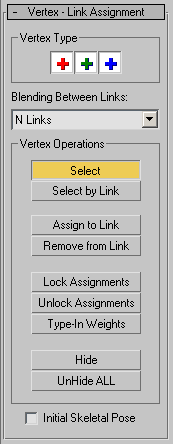

Controls for vertices in a mesh controlled by Physique are on the Vertex-Link Assignment rollout.
Vertex Type group
There are three vertex types, differentiated by color:
Red Deformable vertices that follow Physique’s deformation spline. -
Green Rigid vertices that do not deform but just follow the link they are assigned to. -
Blue Vertices attached to the root node. Physique uses this color when it isn’t sure which link to assign the vertices to. These vertices don’t deform but follow the center of mass object. You should reassign blue vertices to be either rigid or deformable.
While a button of the appropriate color is turned on, you can select vertices of that color. Turn off a button to avoid selecting vertices of that color. You can't turn off all three buttons at once.
- Blending Between Links
This drop-down list provides several options:
- N Links Vertices within all overlapping envelopes are influenced.
While this option is active, vertices can be assigned only to the envelopes they fall within. Envelopes are used by Physique in this case to define the blended weight of each vertex.
- No Blending Vertices are influenced by only one link, as in character studio 1.
This is useful as a general default if you are developing characters for a game engine that doesn't support blending. At the Vertex sub-object level it is useful to override blending weights defined by envelopes, and assign vertices to links as either Rigid or Deformable. For example, after selecting vertices of the skull and face, turn on No Blending, turn on Rigid vertices, turn on Assign To Link, and then click the head link. This will override the head envelope vertex assignments and assign these vertices as rigid to the head link. Use Lock Assignments to lock any changes (see below).
- 2, 3, 4 Links Vertices are influenced only by the specified number of closest links. This is useful when developing characters for a game engine with limited blending.
Vertex Operations group
- Select
- Selects vertices using the selection tools on the main toolbar.
- Select by Link
- Selects vertices by link.
- Assign to Link
- Assigns the selected vertices to a link.
To assign the currently selected vertices to a link, turn on Assign To Link and then click the link.
Assign To Link has a dependency on the envelopes defined for each link, and you must set Blending Between Links to "No Blending" to override this. After vertices are assigned manually in this way, use Lock Assignments to keep them from being reassigned inadvertently during subsequent operations.
Note: You must select or assign a link by clicking the link; you can't use the Select From Scene dialog to select or assign a link while you use Physique to work with vertices. - Remove from Link
- Remove the selected vertices from a link. Note: Select, Select By Link, Assign To Link, and Remove From Link will act only on vertices specified by the red, green, and blue Vertex Type (“+”) buttons.
- Lock Assignments
- Locks vertex assignments.
Lock will prevent any changes from being made to the weights and blending presently assigned to the selected vertices. After any manual assignment of vertices, they should be locked. Before using type-in weights, vertices must be locked. When manipulating envelopes in difficult areas of the character, you might choose to lock vertices that are working well before changing the envelopes to affect other vertices.
Note: If additional data, such as more vertices, comes up the modifier stack, Physique notes the proximity of new vertices to the locked vertices. It then locks the new vertices based on proximity. Already locked vertices will not be unlocked. - Unlock Assignments
- Unlocks vertex assignments.
Click Unlock Assignments on selected locked vertices prior to reassigning them to another link, or changing their blending settings.
- Type-In Weights
- Displays the Type-In Weights dialog, which you use to enter a weight for selected locked vertices; only the weight for locked vertices can be changed.
To use this feature: select one or more vertices, then lock them. Click this button to display the Type-In Weights dialog, select a link from the drop-down list, and change the weight of that link to position the vertices (vertex positions update in the viewports as the weight changes).
You can use type-in weights for stubborn vertices that fall in blended regions between two or more envelopes. Subtle adjustments can be made to the vertex weights of specific links that would be difficult to achieve by adjusting envelopes alone.
Tip: Type-In Weights is useful mainly for correcting flaws in low- to medium-resolution meshes. On a high-resolution mesh, adjusting envelopes should be used to correct deformation. - Hide
- Hides the selected vertices
- Unhide ALL
- Unhides all vertices.
- Initial Skeletal Pose
- When on, puts the mesh into its original pose; that is, the pose it was in when Physique was first applied. Default=off.
