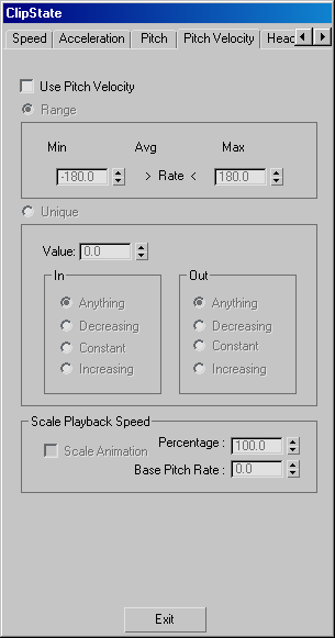

To have delegate pitch velocity considered for motion synthesis, turn on Use Pitch Velocity, choose Range or Unique, and then make the appropriate settings.

Pitch velocity is determined by the rate of change in degrees per frame of the angle of the delegate about the world X-axis. In other words, pitch velocity measures how fast the delegate is changing its pitch.
Interface
Use Pitch Velocity
Turn on to have the motion synthesis engine consider pitch velocity in determining whether to activate the state.
Range group
When you choose Range, the motion synthesis engine activates the clip when the delegate's pitch velocity falls inside the specified range.
Min/Avg/Max Display
After you synthesize the Master Motion Clips, displays delegates' minimum, average, and maximum pitch velocity.
Min
Set a minimum pitch velocity for the range.
Max
Set a maximum pitch velocity for the range.
Unique group
When you choose Unique, the motion synthesis engine activate the clip when the delegate's pitch velocity matches a specific value, optionally with a rising, falling, or constant value before or after the specified value.
Value
Set a unique pitch velocity value.
In and Out groups
These radio buttons let you specify the behavior of the parameter before and after the unique value is met.
  • Anything Pitch velocity before or after the target value is not relevant.
  • Decreasing Pitch velocity decreases before or after it reaches the target value.
  • Constant Pitch velocity before or after the target value is constant.
  • Increasing Pitch velocity increases before or after it reaches the target value.
Scale Playback Speed group
These settings let you scale the rate at which the animation is played, depending upon the pitch velocity of the delegate. By default, when Scale Animation is off, the object animation will always play at its normal rate. If you turn it on, you can then set a Base Pitch Rate, at which the animation should play at its normal rate, plus a percentage to specify how much the animation rate is modified by the actual delegate pitch velocity.
Scale Animation
Scales the clip's animation based on pitch velocity.
Percentage
Specify how much to alter the playback speed based upon the difference between the delegate's pitch velocity and the Base Pitch Rate setting.
The formula used is this:
Animation Speed change % = (current speed/Base Pitch Rate – 1) x Percentage %
For example, if a delegate's pitch velocity is 50 percent above its base heading rate, and the Scale Percentage value is 50, then the playback speed is scaled up by 25 percent.
Base Pitch Rate
Specifies the delegate pitch velocity at which the animation should be played back at its normal rate.
