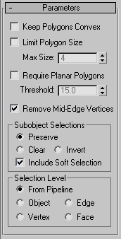

Parameters rollout
- Keep Polygons Convex
- Does not join across edges if the resulting polygon would not be convex. "Convex" means that you can connect any two points in the polygon with a line that doesn't go outside the polygon. A polygon is not convex if you can draw a line between vertices and that line lays outside of the polygon.
Problems that can occur with non-convex polygons include the fact that changes in the geometry of the input object can result in a different topology for the Turn To Poly result. For instance, in a box, if you drag one of the top corners across the middle of the top face, the box becomes non-convex. Turn To Poly would then see this as two triangles instead of one quad, and the number of points in the result would change.
- Limit Polygon Size
- Limits the number of sides to a polygon so that the surface is better defined. For example, you might want to produce a polymesh of triangles and quads, or one composed of all triangles, rather than joining together more than two triangles into pentagons, hexagons, and so on.
- Max Size
- The maximum number of sides to a polygon.
- Require Planar Polygons
- Creates polygons composed of flat planes. Does not join faces together across an edge if the edge has a sharper angle than the threshold listed.
- Threshold
- Controls the threshold of the angle between polygonal planes.
- Remove Mid-Edge Vertices
- Eliminates divisions that result from intersections with invisible edges.
