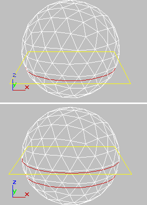

To create multiple slices:
- Select an editable mesh.
- On the
Modify panel, choose the object's Edge (or Face, Polygon, or Element) sub-object level. -
When working at the Face, Poly, or Element level, select one or more sub-objects. At these levels, slice affects only selected sub-objects; at the Vertex and Edge levels, it affects the entire mesh. - In the Cut And Slice group, click the Slice Plane button.
- Position and rotate the Slice Plane gizmo to where you want the first slice.
- Click the Slice button. The object is sliced.
- If you want, move the Slice Plane to a second position and click the Slice button again.
- Click the Slice Plane button again to turn it off and see the results. Tip: For a better look at the resulting mesh, turn off Edges Only on the Display panel
DisplayProperties rollout.
Slice gizmo placed for first slice (top) and second slice (bottom)
