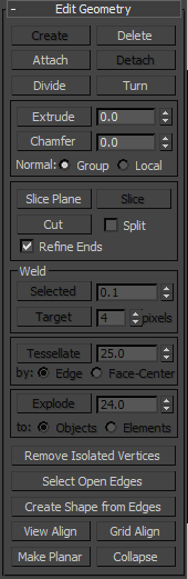

To create a shape from one or more edges:
- Select the edges you want to make into shapes.
- On the Edit Geometry rollout, click Create Shape From Edges.
- Make changes, as needed, on the Create Shape dialog that appears.
- Enter a curve name or keep the default.
- Choose Smooth or Linear as the Shape Type.
- Turn on Ignore Hidden Edges to exclude hidden edges from the calculation, or turn this feature off.
- Click OK.
The resulting shape consists of one or more splines whose vertices are coincident with the vertices in the selected edges. The Smooth option results in vertices using smooth values, while the Linear option results in linear splines with corner vertices.
When you region-select edges, all edges are highlighted, including hidden edges, which are displayed as dashed lines. As a default, the Create Shape function ignores the hidden edges, even though they're selected. Turn off Ignore Hidden Edges if you want to include the hidden edges in the calculation.
If the selected edges are not continuous, or if they branch, the resulting shape will consist of more than one spline. When the Create Shape function runs into a branching 'Y' in the edges, it makes an arbitrary decision as to which edge produces which spline. To control this, select only edges that will result in a single spline and use Create Shape repeatedly to make the correct number of shapes. Then use Attach in the Editable Spline to combine the shapes into one.
