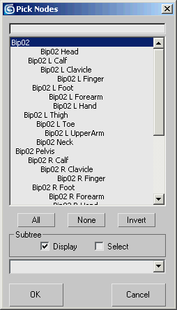

This dialog opens when you pick nodes for velocity blending or sub-blending. If you click the Select Velocity Nodes button, the list displays only the objects being mixed in the current transition track. If you click the Select Sub-blend Nodes button, the list displays only the objects being mixed in the current transition track, except those objects that are already velocity blends.
Interface
- [search field]
- To find an object in the list, enter the object's name and then press Enter.
- [node list]
- Lists all the available objects.
- All
- Selects all objects in the list.
- None
- Selects no objects in the list.
- Invert
- Inverts the current list selection.
Subtree group
- Display
- When on, the object hierarchy is shown by indenting. When off, all objects appear at the same level. Default=on.
- Select
- When on, selecting an object selects that object's children. When off, only one object at a time is selected. Default=off.
- [named selection sets drop-down list]
- This list shows the scene's named selection sets. Choosing a set from this list selects its members in the Node list.
