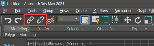

Select and Link and Unlink buttons on the toolbar.
You link from the currently selected object (child) to any other object (parent).
