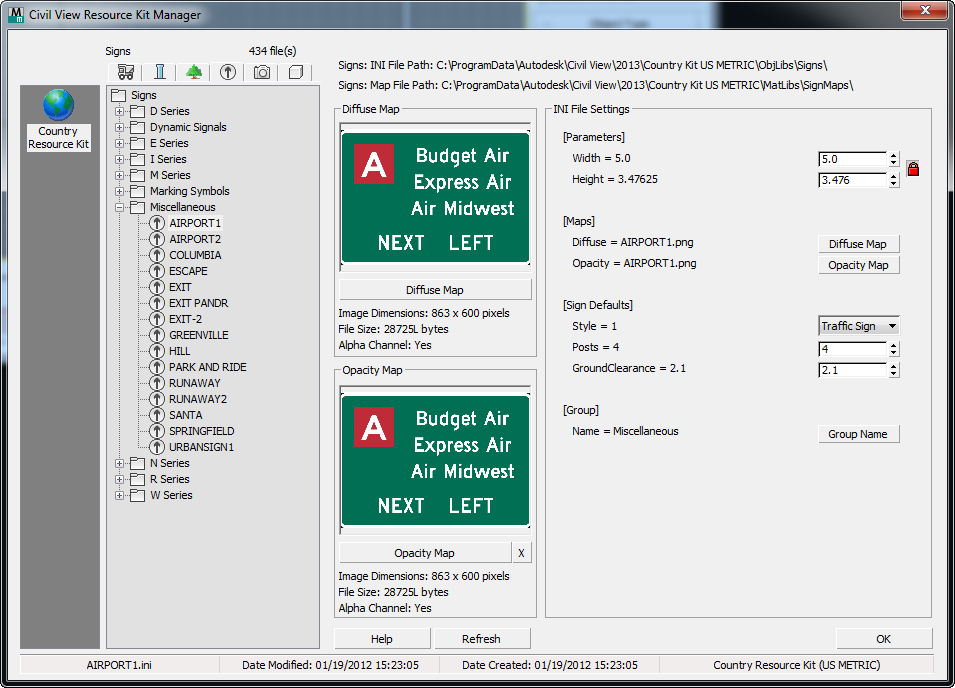

Interface
[resource kit selector] (left-hand column)
Displays the active resource kits.  To activate project or private resource kits, use the Civil View Preferences.
[object category] (middle column)
Use the tabs at the top to choose an object category, and the list below to choose a library object to edit.

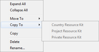

Right-click an entry in this list to delete or rename the object, or move or copy it to a different resource kit. The right-click menu also manages the list itself.
[object settings] (right-hand panel)
The top of this panel shows the paths for this object's INI file, as well as the paths of bitmaps or the MAX file, depending on the object type. The remainder of the panel shows the settings for the object: This is a graphic presentation of the INI file contents, as described in the topics in this section. You can use these controls to change the object settings, but remember that changes you make in this panel cannot be undone.
