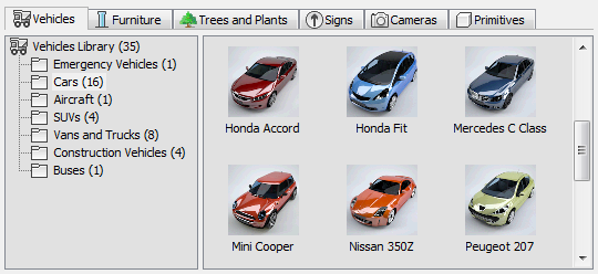

Object Category Groups
In addition to object categories, you can split each set of object definitions within a single category into sub-groups. For example, vehicles might be organized into cars, trucks, buses, and trains. Signs might be organized into advisory signs, mandatory signs, and road-marking symbols.
Additionally, with Object Placement Styles it is possible to define a style element that places a group of objects in a scene with a single instruction, rather than having to select one object definition at a time. In this case, individual objects within the selected group are randomly chosen for placement in the scene. For example, this can be useful with vehicles, where you want to place a range of different vehicles onto a highway.
