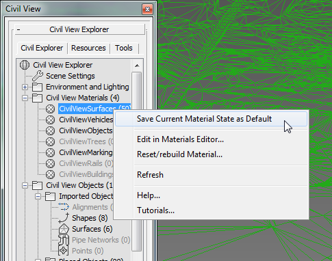

To alter the initial state of the CivilViewSurfaces material for other scenes that share the same 3ds Max Project Folder, you have two options:
Overwrite the automatically generated CivilViewSurfaces material in the civilviewsurfaces.mat file with a custom Multi/Sub-Object material of the same name.
An easy way to achieve this is to customize the material to your personal preferences in 3ds Max, then right-click the CivilViewSurfaces material in the Civil View Explorer panel and choose Save Current Material State As Default.
Delete the current civilviewsurfaces.mat file. This will ensure that subsequently created scenes that share the same 3ds Max Project Folder will use the hard-coded defaults. A new civilviewsurfaces.mat file (based on these hard-coded defaults) will be created next time the material is loaded into a new scene.
