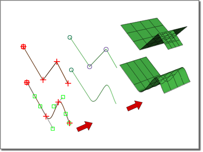

You can turn a spline into a NURBS object formed of CV curves. Once converted, you can no longer edit the spline shape parametrically, but you can edit it as a NURBS object, moving CVs and so on.
Splines become NURBS curves that then become NURBS surfaces.
When you convert a spline circle to a NURBS curve, the direction of the curve is reversed. This facilitates using the curve to trim a surface: if the direction weren't reversed, usually the circle would trim outward instead of inward.
