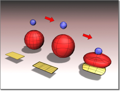

You can turn a standard primitive into a NURBS object formed of CV surfaces. Once converted, you can no longer edit the object parametrically, but you can edit it as a NURBS object, moving CVs and so on.
Primitive objects become NURBS surfaces that you can then edit in various ways.
You can't convert most extended primitive objects in this way, but you can convert the torus knot and prism extended primitives to NURBS objects.
You can also convert patch objects and loft compound objects.
