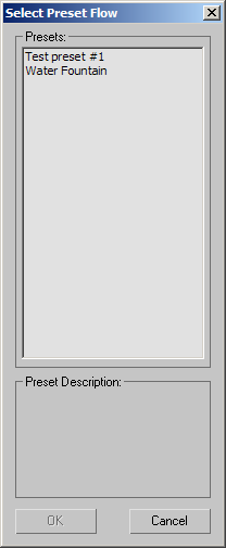

To add a Preset Flow, drag Preset Flow into the event map of Particle View. The Select Preset Flow dialog opens. Highlight a preset and then click OK, or simply double-click a preset name.

Interface
- Presets
- Lists the current presets in the system. Add a preset either by double-clicking its name or by highlighting it and then clicking OK.
- Preset Description
- Displays the description for the highlighted preset. To scroll a description that is too long to fit into the visible space, place the cursor in the description area and use the down-arrow and up-arrow keys.
- OK
- Adds the selected preset.
- Cancel
- Cancels the merging of presets.
