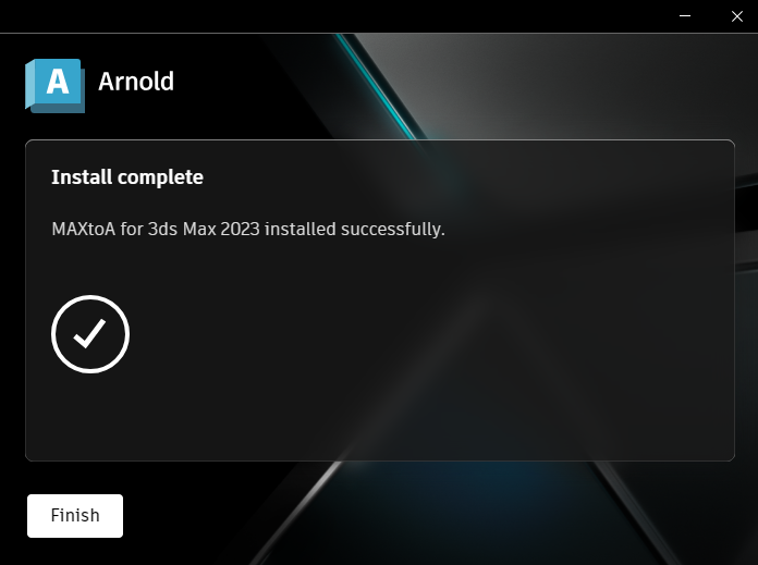

  3. Keep the default installation options, and click through the Setup Wizard until the setup is completed.
  4. Agree to the Terms of Use.
  5. Click Finish to close the Setup Wizard.

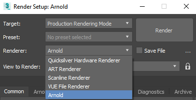

  1. Start 3ds Max and open the Render Setup window. Arnold should appear as the default renderer in the list of available renderers. You should now be able to render with Arnold.
