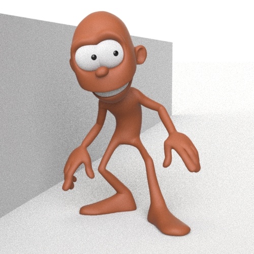

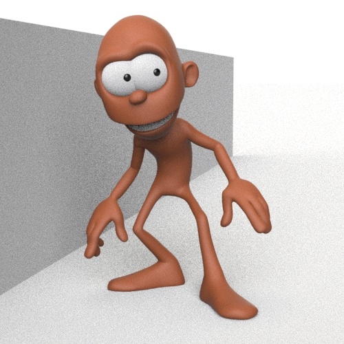

Renders computed with too few samples in each pixel can be noisy. Increasing the number of samples per pixel gives a less noisy image which better represents the actual scene. The images below show a comparison when increasing the number of Camera (AA) samples in a scene. Not only does increasing Camera (AA) samples reduce aliasing noise, but it also adds more secondary ray samples which also reduces noise in the lighting.
1 Camera (AA): 1x1=1 sample per pixel (image appears noisy) | 6 Camera (AA): 6x6=36 (noise is reduced) |

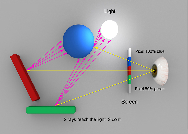

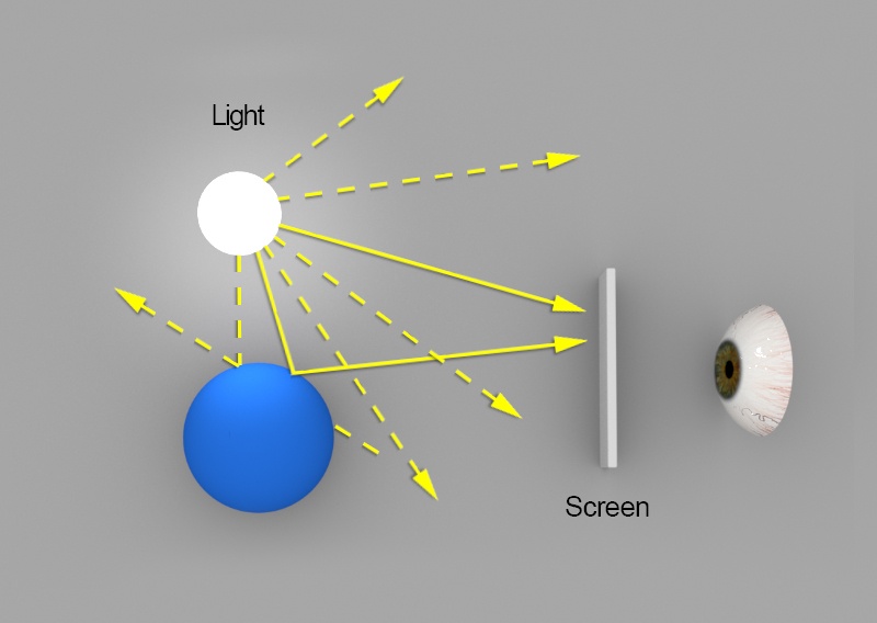

Direct lighting rays can be described as rays which deal with lights. These rays travel from a position in the scene toward the various light sources. These rays determine if a surface is in shadow, and if not, lighting information can be calculated.
Noise from lights can sometimes be difficult to diagnose, particularly if it is a light with a large area or size. In these cases, it can sometimes be mistaken for indirect diffuse noise. This highlights the necessity for testing different noise ray types. If the issue is shadow noise, then we can simply toggle ignore shadows in the Arnold render settings, and the noise will completely resolve. The images below show how a light is traced in Arnold.
Some light rays hit an object while others do not | Light sampling in Arnold |

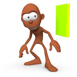

Diffuse Ray Sampling

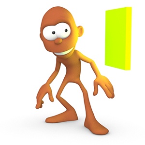

indirect (diffuse) lighting from emissive green cube | direct lighting only (diffuse_samples: 0) |

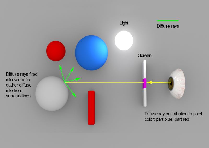

Indirect diffuse rays are rays that interact with objects and their surface shaders. Therefore, rays travel in the scene in directions determined by the shader assigned to the object. The transmission rays travel through objects. When a ray hits a reflective object, such as a mirror, only one reflection ray is traced from that point in a direction determined by the incoming ray. In contrast, diffuse rays are sampled randomly over the hemisphere around the hit point.
Diagram showing how diffuse rays are propagated in an Arnold render

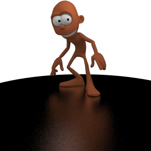

When rendering glossy specular surfaces, noise can also be a problem, as with diffuse rays. Bright hotspots can cause noise in indirect specular samples. For example, wide specular reflections of small, bright lights. If the issue is noise in a specular highlight, it needs to be confirmed that the source is the direct light and not a secondary ray type (such as specular). This is easy to achieve by setting the GI_diffuse_depth, GI_specular_depth to zero (this essentially turns off all global illumination). If the noise is still there, we know it is the direct specular component of the illumination model. In most cases, it can be resolved by increasing the number of specular samples.
1 (insufficient samples) | 4 (sufficient samples, noise is reduced) |

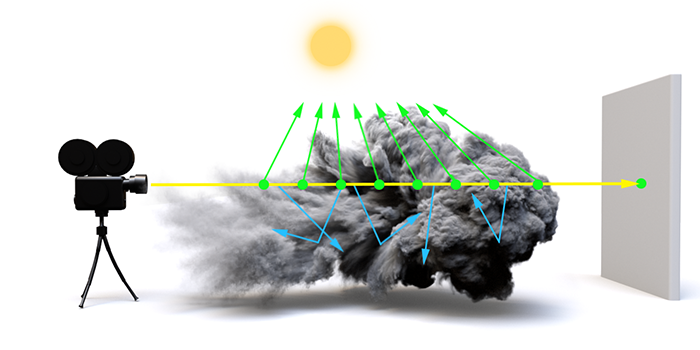

When sampling volumes, direct Camera (AA) rays sample the volume multiple times as they travel through it. Indirect rays ( volume_indirect) behave similarly, sent multiple times as the ray 'steps' (volume step_size) through the volumetric object. Therefore, sampling a volume usually takes longer to calculate than sampling a surface.
Volume sampling. Direct lighting (green). Indirect lighting (blue).

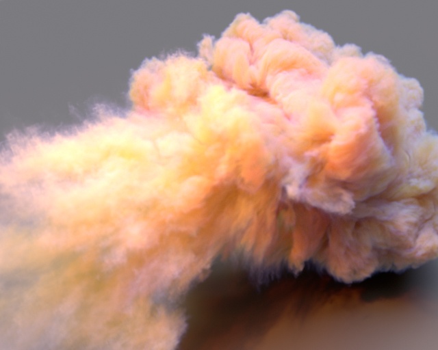

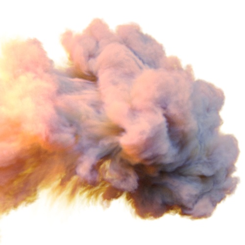

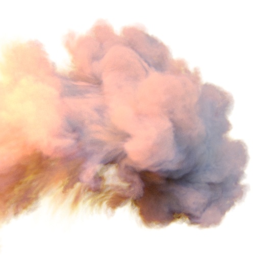

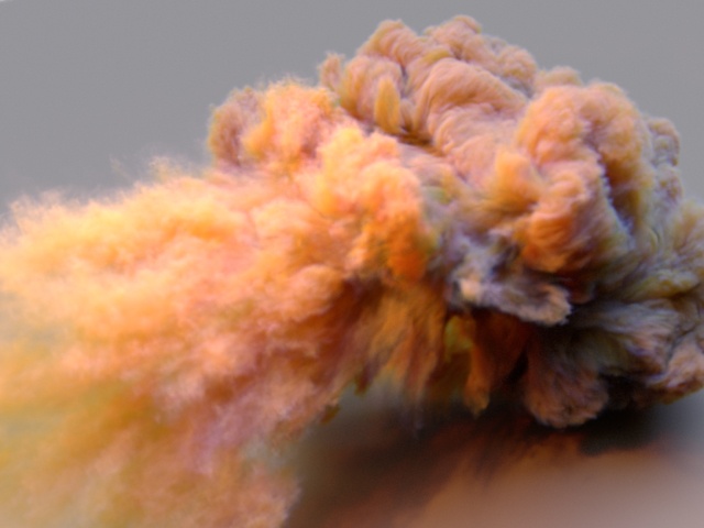

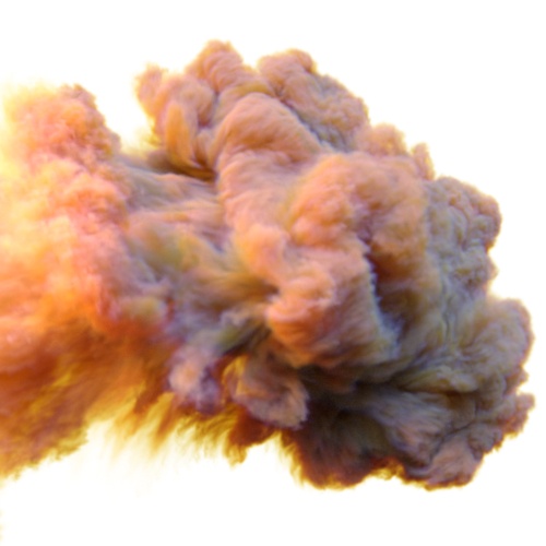

At each step the ray travels, it evaluates the shader and accumulates the density of the volume. When these density values become more erratic throughout the volume, nearby rays can calculate substantially different values, introducing noise into the render. In this case, it may be necessary to render using more light volume samples or to reduce the step size in the volume. Even with low sampling values, it can be expensive to render clean images with volumes.
Light volume samples: 1 | Light volume samples: 6 |

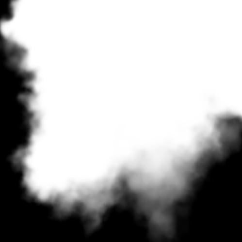

Step Size

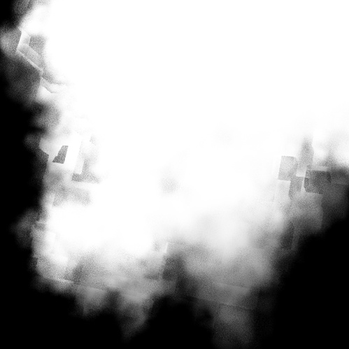

The step_size of the ray marching process. Too low a sampling rate here will cause the volume rendering to miss small details in the volume, making them noisy, making them thinner than they should be, or making a bad estimate of the exact position of the 'surface' of a 'solid' volume like a pyroclastic cloud. A bad step size has a snowball effect that can make the rest of the sampling process noisier. This is pretty easy to test by looking at the alpha channel, or by adding some emission to the volume and turning off all lighting. If the emission/alpha channel is noisy at the desired Camera (AA) setting, then the step_size is probably too large.
step_size correct | Artifacts appear in the alpha when the step_size is too large |
Step_size is actually in object-space and not in world-space. This is so that the sampling quality remains the same upon scaling of the volume's transformation. However, u nreasonably large step sizes should be avoided. Otherwise, the volume will appear thinned and washed out. In the example images below the volume has been scaled up to 100 units to exaggerate this effect ( 1/25/50 are relative to the size of this volume).
1 | 25 | 50 |
Generally, the step_size needs to be as large as possible before visibly noticeable artifacts occur. Low step sizes will increase render times. For example, when the step size is 0.1, and the volume is 10 units big in world space, there are approximately 100 primary samples, and therefore the volume shader is called 100 times.

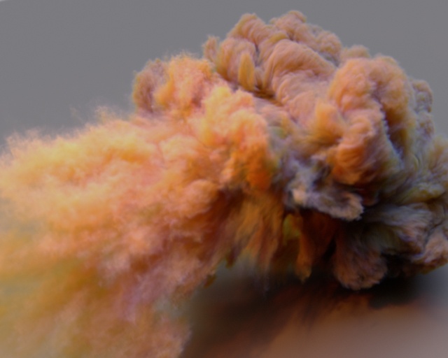

Volume ray depth
Increasing the volume_ray_depth can make a dramatic difference to the appearance of a volume. However, be aware that increasing the volume ray depth will increase the number of multiple scattering bounces within the volume (defaults to 0), and therefore render times will increase significantly.
0 | 6 |
