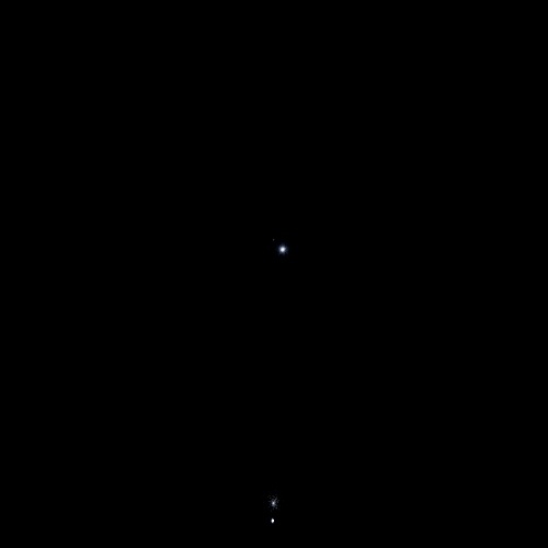

  • Reduce the specular_roughness to a very low amount. Something like 0.004. This value will depend on how high the specular_ray_depth is set. With a high specular_roughness value and a high specular_ray_depth the resulting render may look too bright.

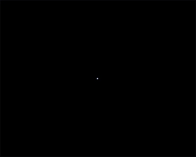

  • Render the scene. You should see something like the render below using the default Arnold render settings.
Render using the default specular_ray_depth: 1

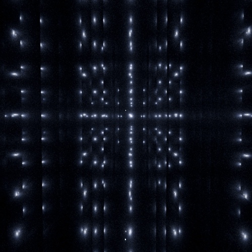

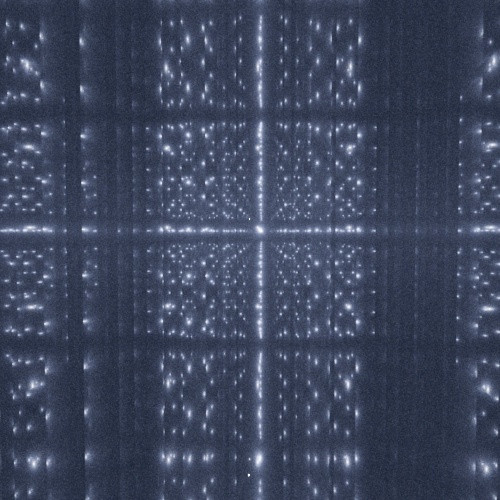

Specular Ray Depth
  • Try increasing the specular_ray_depth to see more internal reflections of the point light.
Important:
Increasing the specular_ray_depth value will dramatically increase render times.
1 (default) 10 20
