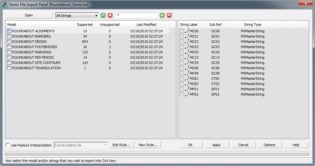

Open
Click to open a file dialog and browse to the MX file you want to use.

[selection options]
This group of controls provides filtering options to help you select portions of one or more models.
[string type drop-down list]
Lets you choose either All Strings (the default), or one of the particular string types available in the active model.
[check-mark button]
Click to select the strings that match your choice from the drop-down list.
[X button]
Click to deselect the strings you have selected.
[wildcard field]
Lets you narrow the string selection by entering a wildcard expression. Default = * (select all).
You can also use the file contents list to select strings individually, or right-click the list to see a menu with additional selection options.
[plus-sign button]
Click to select those strings that match the wildcard field.
[minus-sign button]
Click to deselect those strings that match the wildcard field.
[model list]
Lists the models in the MX project. Click a model to highlight it. You can highlight only one model at a time, although you can select strings from multiple models before you finish using the Model File Import panel.
[file contents list]
Lists the strings contained in the highlighted model, by label. This list also shows the string type and number of points. For triangulation strings, the number of triangles found in each string is also displayed.
