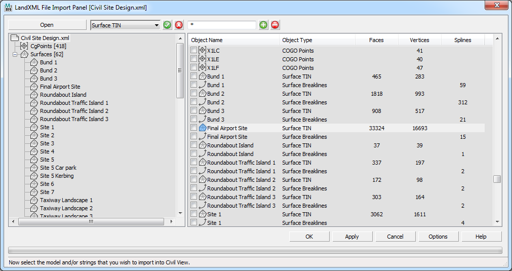

Open
Click to open a file dialog and browse to the LandXML file you want to use.

[selection options]
This group of controls provides filtering options to help you select portions of one or more models.
[string type drop-down list]
Lets you choose either All Strings (the default), or one of the particular string types available in the active model.
[check-mark button]
Click to select the strings that match your choice from the drop-down list.
[X button]
Click to deselect the strings you have selected.
[wildcard field]
Lets you narrow the string selection by entering a
wildcard expression. Default = * (select all).
You can also use the file contents list to select strings individually, or right-click the list to see a menu with additional selection options.
[plus-sign button]
Click to select those strings that match the wildcard field.
[minus-sign button]
Click to deselect those strings that match the wildcard field.
[file contents list]
The tree view on the left shows the full hierarchy of supported objects in the LandXML file. Click anywhere within this tree to filter the displayed contents of the list view to specific types of object. You can select the root node of the tree view to display the full contents of the file in the list view on the right, or select any other node within the tree view to limit the displayed list to specific parts of the data set.
The list view on the right shows a list of objects that are related to the current tree view selection. A right-click menu lets you select objects from list using a range of criteria such as object type or name.
Some feature labels in the list might appear grayed out. This can happen for a couple of reasons:
  • The feature has already been imported into the current scene.
    Civil View automatically checks all feature and model names against previously imported features. If any identical feature label and model name combination already exists in the current scene, the corresponding list item is disabled.
