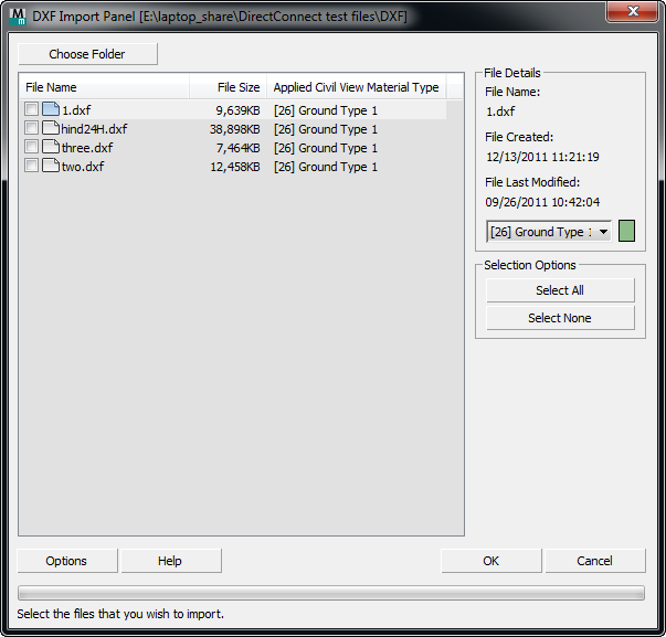

Choose Folder
Click to open a dialog where you can browse to folder that contains the DXF files you want to use.
[file list]
Lists all DXF files in the active directory. Also shows the size of each file in kilobytes, and the CivilViewSurfaces material channel associated with each file (see below).
You can select an individual file in the list by turning on its checkbox.
DXF File Details group
Shows details about the currently highlighted file.
[material channel drop-down list]
Shows the sub-material and wireframe color assigned to the highlighted DXF file. The sub-materials are channels of the CivilViewSurfaces material.

Selection Options group
Select All
Click to select all files in the list.
Select None
Click to deselect all files in the list.
Options
Click to open the Import Options tab of the Civil View Preferences panel, where you can set a range of geometry import defaults, such as the mesh smoothing threshold angle.
