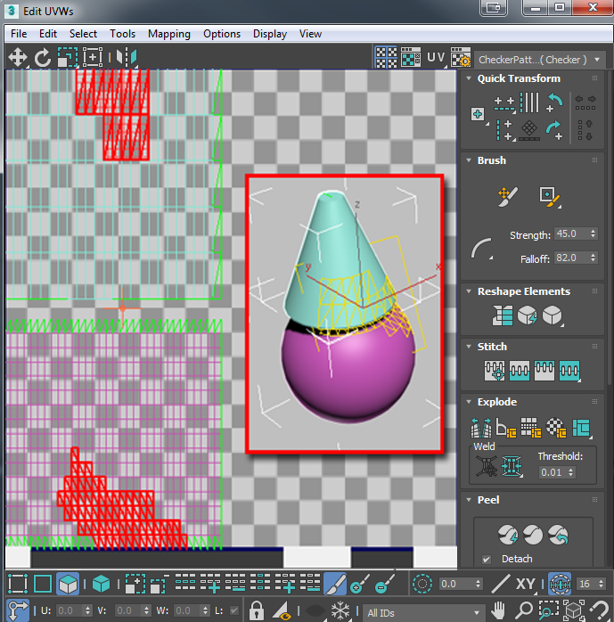

Support for Multiple Unwrap Objects
Instancing capabilities in Unwrap UVW make it easy to apply texture coordinates across several objects. First select the objects, then apply Unwrap UVW. When you open the editor, you’ll see the mapping coordinates for all selected objects containing the instanced modifier. The editor shows each object’s wireframe color to help you see which set of coordinates belong to each object.
Left: Two objects’ UVW coordinates in the editor, showing wireframe colors
Right (inset): The objects with a shared Unwrap UVW modifier in the viewport
Tip: The UVWs of different objects typically start out overlapped in the editor, so it’s a good idea to separate them before editing. To save time, use one of the Pack tools.

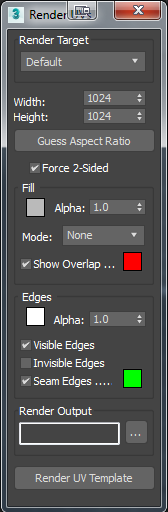

  2. From the Edit UVWs dialog menu bar, choose Tools Render UVW Template.
    Note: If your driver does not support the graphic mode, you cannot select Render UVW Template.
    This opens the Render UVs dialog:
  3. Select the render target.
  4. Set the Width and Height values to the output resolution you want in the rendered template. You'll usually get good results by setting the desired width and then clicking Guess Aspect Ratio.
    Tip: When creating texture maps for gaming and other real-time 3D engines, be sure to set both dimensions to powers of 2: 256, 512, 1024, and so on.
  5. Change the remaining values as needed. By default, the template is rendered with the edges as white and opaque (alpha=1.0), and background is empty and transparent (background alpha=0.0), but you have a variety of choices here, as detailed in Render UVs Dialog.
  6. At the bottom of the dialog, click Render UV Template.
    This opens a new rendered frame window containing the rendered template as a bitmap. Inspect the output, and if changes are necessary, make them on the Render UVs dialog and re-render.
  7. When you're satisfied with the results, then on the rendered frame window toolbar, click Save Bitmap, and then use the file dialog to specify the file type and name. Click Save to export the file.
    If you want to use the rendered transparency information in the paint program, be sure to save in a format that supports the alpha channel, such as TIF or Targa.
  8. Open the exported image in a paint program and use the rendered edges as a guide for painting the texture map. Save the image when done.
    Be sure to paint over or erase all the edges so they don't appear in the final texture.

Select by Element XY Toggle
When on and and a sub-object level of the modifier is active, clicking an element in the modified object selects all sub-objects at the active level in that element. This is different from the Select by Element UV Toggle on the Edit UVWs dialog toolbar, which applies to clusters of texture coordinates.

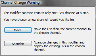

Please note the following important points about map channels in the Unwrap UVW modifier:
  • Each modifier contains edits to only one channel, set in the modifier.
  • The mapping in this modifier must use the same channel set in the material's image map (see following list).
  • Changing the map channel in the modifier opens a Channel Change Warning dialog that gives you the option to copy the existing edits to the new channel, or abandon them and use the mapping this channel contained before this modifier changed it (see following illustration).
  • To apply different mapping coordinates for different maps on the same object, use a new modifier with a unique map channel per image map. You can collapse the stack when finished, and the mapping is preserved.
