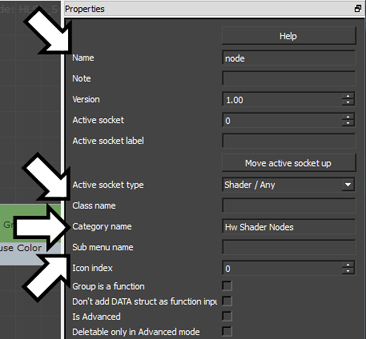

- Select the group node and click its
Group icon to visualize the group network. - In the group network view, select the group node at the left. In the Properties panel, you can customize the following attributes:
- Name
- Category
- Sub menu name
- Class name
Customize these categories.

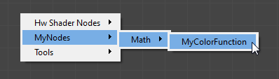

- In the ShaderFX editor, choose Group menu
Save Group To Disk. Your group node, now renamed to Name, is now accessible when you right-click the work area. It appears on the right-click menu as Category name
Sub menu name
Class name.
A custom group appears on the right-click menu.
