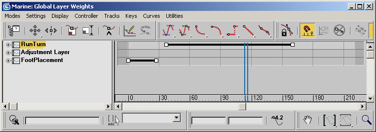

- On the Layer Manager rollout, click
(Dope Sheet: Layer Ranges). The layers are displayed as individual tracks.
Ranges View
- The ranges for the layers can then be squashed, stretched, and moved as usual in 3ds Max. They can also be reversed.
The range for a layer is specified by the first and last keyframes on any track for any part of the rig. If a range extends before the start or beyond the end of your animation, one of the rig bones might have rogue keyframes. 3ds Max creates a keyframe at frame 0 whenever you keyframe (using Auto Key) an object for the first time. This can create an unintended keyframe.
Whenever you use Ranges View to edit the keyframes on a layer, all the keyframes on the rig are moved. You can see this clearly by selecting a bone with keyframes and then editing the layer range bar.
Moving Keyframes in Time
To move all the keyframes on a layer, drag the bar to the left or right.

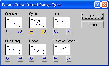

Setting Looping Options for a Layer
To access the looping options for this layer, click the Parameter Curve Out-of-Range Types' button.
You might have an animation on a layer that you would like to repeat in some way. This could be a simple action like a breathing motion on a ribcage, or a while walk cycle. You can use the ranges view to set the looping options for the entire layer.
Remember that each controller on the rig loops separately, so to get the whole layer to loop at the same time, you might want to set the layer time range manually (see following).

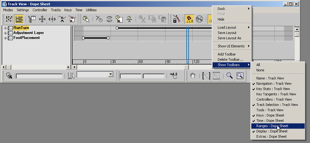

Setting the Layer Time Range Manually
Each controller in the rig has its own time range, which is defined by the first and last keyframes on that controller. This means, for example, that if you want your animation to loop, then each controller will loop according to its own time range. As a result, the whole animation can get out of sync and look incorrect. If you set the time range manually, you can force all the controllers on the character to use the same time range, thereby ensuring correct looping.
To use position ranges on an animation layer:
- In Dope Sheet mode, right-click the toolbar area of Track View.
- From the menu, choose Show Toolbars
Ranges: Dope Sheet. 3ds Max opens the Ranges toolbar.
- Click
(Position Ranges). - Edit the Layer Range as usual.
At some point you might wish to go back to standard range editing. You can do so by clicking
(Recouple Ranges). This resets all the ranges to their default behavior where the time range is defined by the first and last keyframes.
