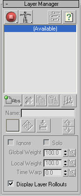

To create an Absolute layer:
Select any part of your CATRig. - On the
Motion panel, go to the Layer Manager rollout.
- Click and hold on
(Abs) so the flyout opens, and then drag down to the second Abs button.
An Absolute Layer is created in the Layer Manager list.
- Above the list, click
(Mode) to switch to Animation mode.
You are now ready to start keyframing.
