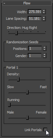

  5. Go to the Modify panel. On the Flow rollout, click to turn off Link Portals.
    The label on the main Flow rollout changes to indicate that this group controls Portal 1. Controls on the Portal 2 rollout are now available, too.

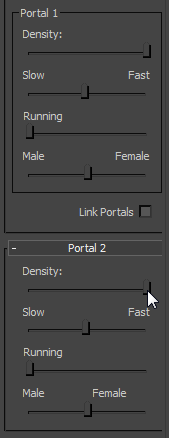

  6. In both Portal groups, drag the Density slider all the way to the right (full Density).
  7. In the Flow rollout Portal 1 group, drag the Slow/Fast slider all the way to the left.
  8. On the Portal 2 rollout, drag the Running slider all the way to the right.
